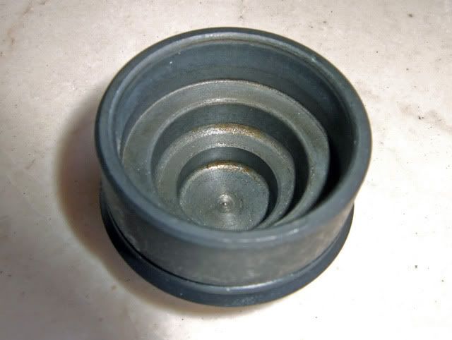

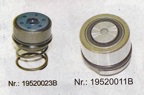

The plan was to use the newer clutch slave piston, part #19520023B to replace the old piston, part #19520011B.ducinthebay wrote:Ethan's idea is to use a clutch slave from a newer version of the Ducati motor on the older version.
However, since the newer piston is used to push a rod through the case (on the 907's, I believe) from the left
side of the case to release clutch plate pressure it doesn't have a "mushroom" i.e. throwout bearing setup. It
just slips onto the end of the rod with a special metal in rubber type seal. (see below)
So, of course after re-reading several topics on the subject here at Ducatipaso.org and with the knowledge
of the inner constructs of the original (19520011B) piston now clear I am facing the daunting task of having to
build a mushroom and bearing assembly to fit into the newer type piston that will withstand the daily torments
of contact with the pressure plate.
The original piston (#19520011B) is constructed in this way.
1st - There is a seal on top.
2nd - after removing said seal, there is a "C" clip to remove.
3rd - you remove the C-clip, pull the "mushroom" out revealing a circle of loose ball bearings.
4th - after removing the mushroom and ball bearings you'll see on the bottom of the mushroom's shaft a vertical, cylindrical case of needle bearings surrounding the base shaft of the mushroom. So what you have inside the now empty piston is that it has a vertical wall, with a slot for the c-clip, ending in a rounded seat for the ball bearings. Then below the ball bearing seat there is an even narrower vertical wall that the needle bearing cage that is around the base of the mushroom fits in. Sorry - I know its a rather pointless description without an accompanying photograph but I made an attempt at drawing it below.
So the problem is that the interior of the newer piston type (see photo below) is very different and has a larger inner diameter so using you existing mushroom and bearings won't work. Other members have posted that they've built a new mushroom and used a 608-ZZ bearing but no one has produced a photo with all the parts and how they've assembled them (that I can find) and to what success . . . The images they've drawn of the fabricated mushroom are not at all like the original. How can you keep the mushroom seated in the piston with out a c-clip? Won't the bottom of the mushroom just sit on the inside of the piston and just wear everything away? So if anyone has any personal experience with using the newer #19520023B piston successfully please drop me a line rather than filling this thread with conjecture.
Thanks, Ethan
