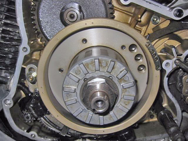

So I fitted the new starter motor, cleaned the water pump
and refitted that, too. I'm wiping down the inside of the
alternator case and prepping the engine cover surfaces
for refitting when I find this:

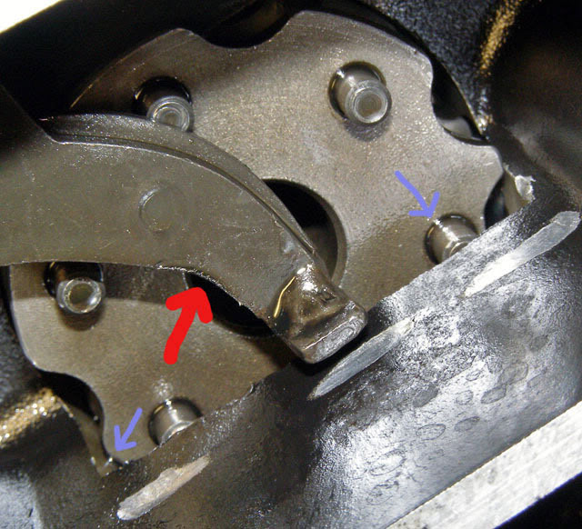

The red arrow indicates where I found this small piece of metal:
Then I notice further up. This...
There is no other damage I can see on this side of the motor.
I have no idea what that hole is, or how it got there, but there
seems to be an awful lot of alloy missing which is NOT on the
alternator side of the engine cover. Please tell me the big hole
at the bottom is the oil pickup and that it goes directly to the
oil filter from there!
Can someone tell me how many thousands of dollars this is
going to cost to fix? I suspect it will be a quite a few.
I guess I diagnosed my false neutrals issue. Not too happy
about it though. *sigh*

The metal piece measures 4mm x 3mm x 1.5mm (I edited the photo.)
It has a black coating on al the surfaces except one, which is a fracture surface - which makes me think it is part of the engine case itself which has broken off.
I took a look at the shop manual, and it *almost* looks like there is meant to be an opening there (behind where I found it), but it is not clear from the diagrams. There is a bearing showing through the gap, but it does not appear to be damaged. Is there normally a hole there which has simply been enlarged? Or has this process actually worn through the side of the case?
I filtered the oil through some pretty fine stockings, and there does not appear to be any solid matter in it at all, nor in the bottom of the oil bucket. But the bike was drained from cold, not warm - could that affect it?

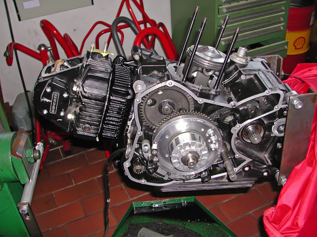

Mobius, do you mean the hole behind the arrow ? That`s normal. It may not have been properly deburred.
This is a friends Cagiva Elefant. it has it, too (if you look close).
and this is mine (it also has the 3 marks from the shifter arm)
I wonder if that piece you found belongs to the right side of the hole, could it be ? If so I`d flush the oil to ensure there`s no other metal particles and that`s it.

I actually pulled off a very thin sliver of alloy, with black surface on it, that was attached to that hole, so it seems reasonably clear that this damage has been caused in situ, and is not a manufacturing/finishing defect.
It looks like it has been milled by particles, or pieces of things - not machine marks.
Note the large whack that has damaged the engine case just aft of the gear selector arm - behind that third indentation created by the armature. Looks like something has come up through the gap and been crunched against the case by the gear changing process. Perhaps I am stunningly lucky, and that only one piece of metal has been loose in the motor, and it got caught up in the U shape somehow.

Looking at your pics again, your shifter arm looks a bit worn. At least mine looks different.
Are those little silver spots metal particles or is that just the reflection of the flash in the oil ?
