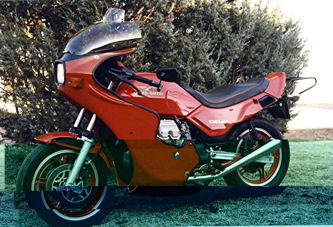

- (331.94 KiB) Downloaded 711 times
- bmw851
- Posts: 322
- model: other
Re: resurrection
the finn wrote: thank you moderators me too. this site is incredibly valuable. as much for the people, as for the information. good to meet you all. it's so hard to find someone who'll listen to a ducatista when he's fired up.
And Daniel's comment as well, thank you.ducinthebay wrote:Thanks again to the site Moderators for adding the Sport page a few years back. Some really good stuff here.
Ian, I like the way you think
