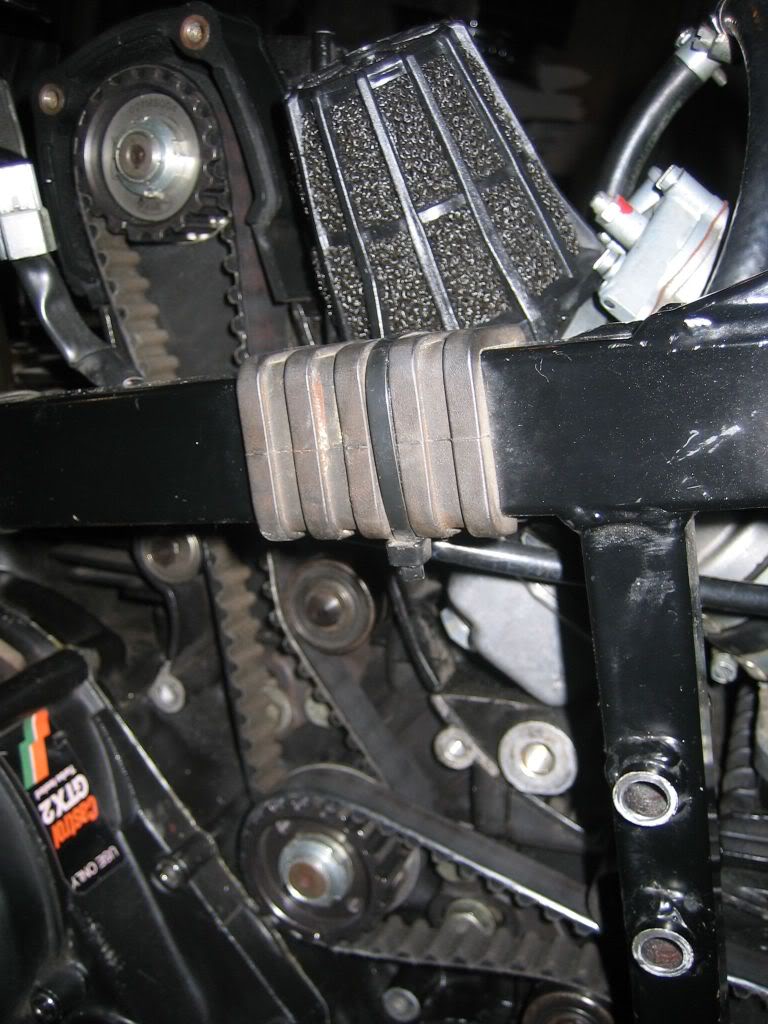

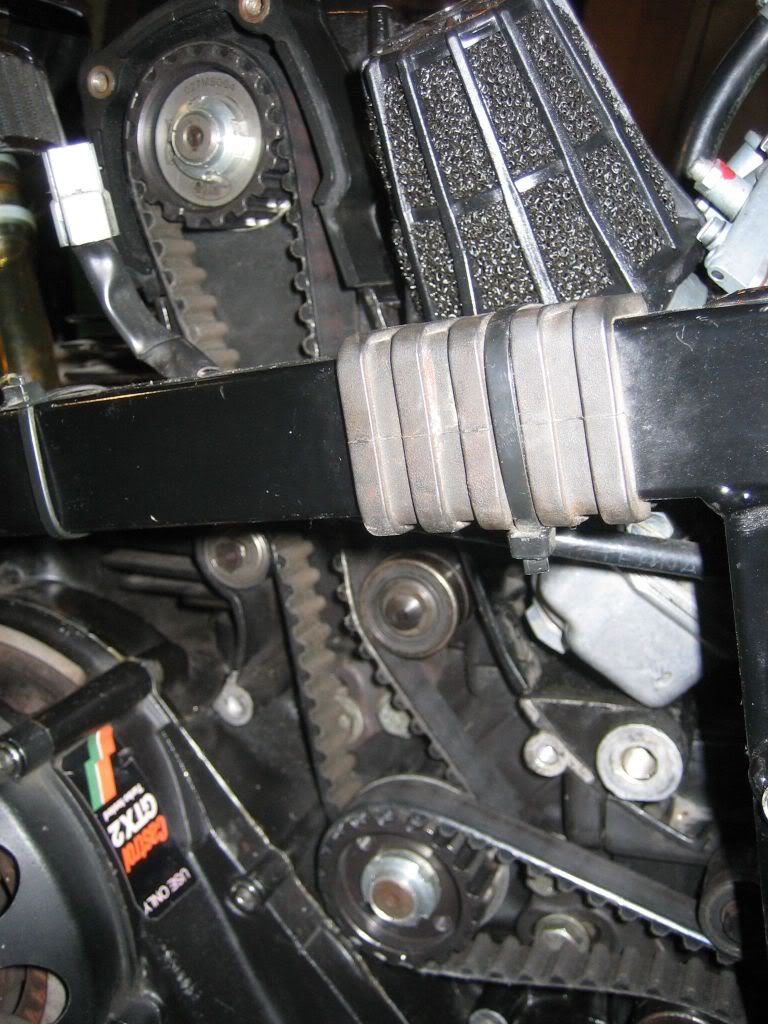

if someone has the belt covers removed could you make a picture of the camshaft and driving pulleys?
I noticed that my belts hang off the camshaft pulleys by 1-2mm. About as much as the thread of the camshaft is showing. The nut of the driving pulley sits on the end of the thread. Looking at the position of the belt on the tensioner pulley it seems the driving pulleys are a bit further out than the camshaft pulleys.

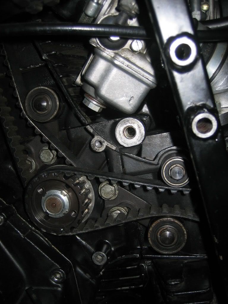

This is what I have:

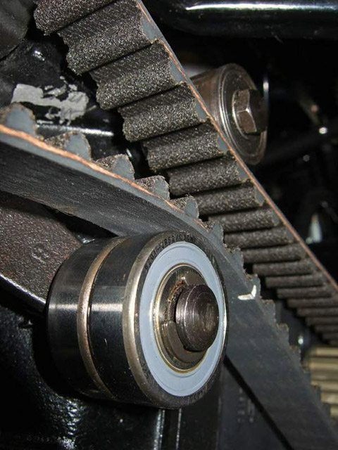

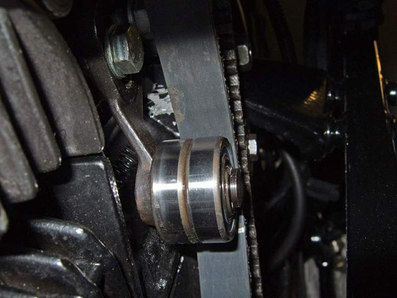

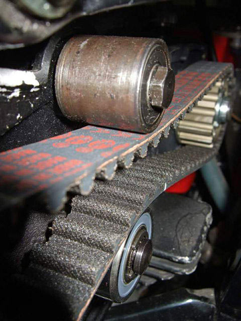

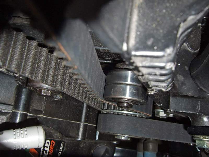

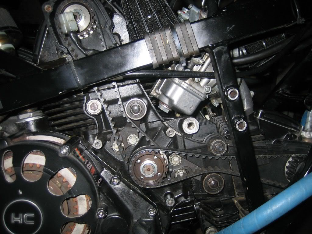

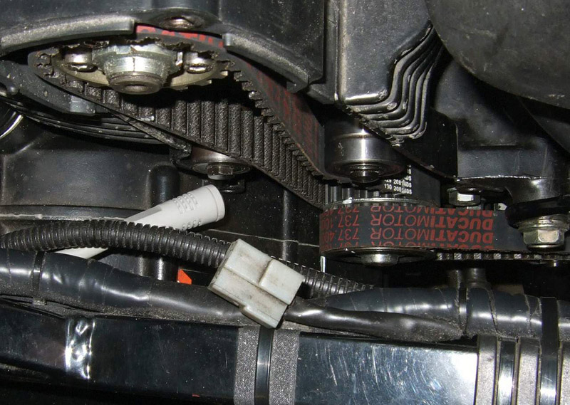

thank you very much! Do your belts run centered on the idler and tensioner pulley?
Mine don`t. Moving the driving pulleys inward would correct that but looking at your pictures it seems they are in the same position as mine (there`s no remaining thread visible) which would indicate that my camshaft pulleys should move outwards but then I doubt that the belts not running in the middle of idler and tensioner pulley is normal.

Re: need pictures of cambelt pulleys
These are old photos, but they may help a bit. I can take new photo closeups of the idler and tensioner pulleys if you need them. Just let me know I could do it tomorrow.

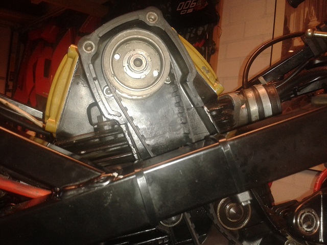

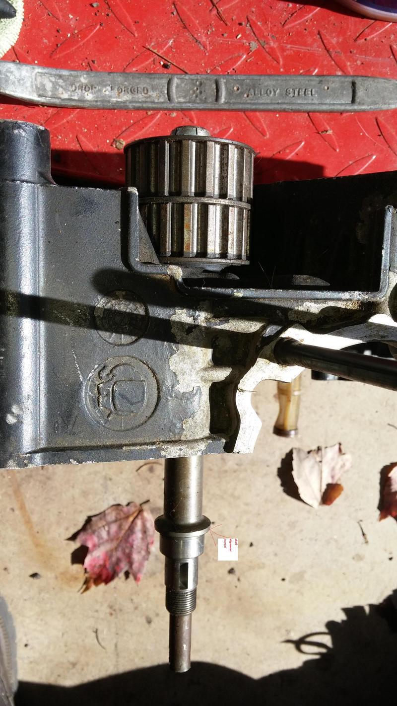

Gerhard, here's a picture of the pulley on the vertical head.

yes I did but that belt offset of course remained. I finally want to figure out what causes it.
Thanks again for the pictures. It would be nice to see some that show the pulleys and belt from the top or bottom to get a better picture of the position of the belt on the idler and tensioner pulley.

I have a 906 crankcase split I'll take a look maybe give me some idea of what to look for
yeah yeah I get it
update: 906 appears to be a little different,timing shaft protrudes further past the timing belt drive gears and their nut
Still curious how the gears on the other end line up
assuming they line up good it has to be the thrust washers, or some other oddball issue like cylinder and head alignment. Don't remember if you bored or replaced the cylinders ?
It does appear the timing shaft is captured in the case halves on the drive side, did you tighten that end first ?
If so I guess your only viable option is loose the thrust washers you have installed for some much thinner ones to get the alignment kosher
Hey I just noticed the timing gears don't line up very well on this spare case half

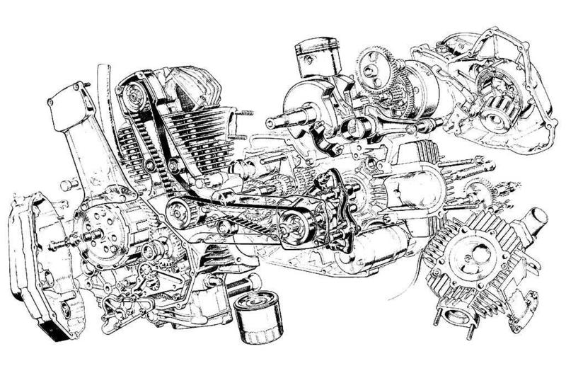

Now that`s an interesting picture
I don`t remember how the pulleys aligned with the old belts and pulleys. Also I let a shop do the whole engine rebuild so there`s not much I can say about it.
I`ve found some topics on other Duc forums about that. At least that lines up on my engine.Hey I just noticed the timing gears don't line up very well on this spare case half
