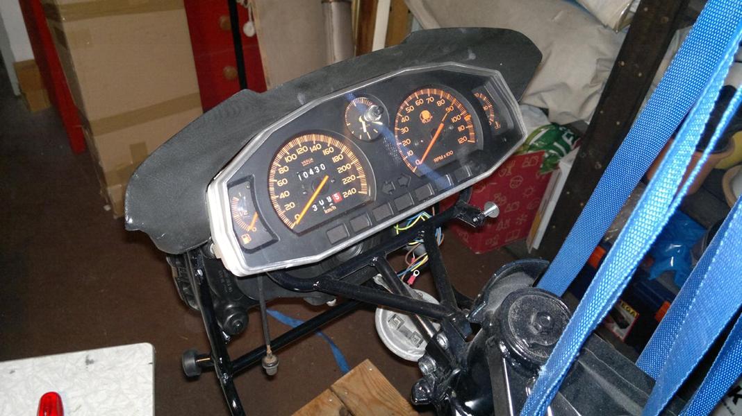

JoKing
Posts: 362
Re: Rebuilding my 907 ST3
Post by JoKing »
Some more pics - watch the comments above the pictures.
Dash from behind...someone tell me please how to connect the ST3 revcounter to the harness...
(71.01 KiB) Downloaded 485 times
Dash in good condition... Fully working, apart from the revcounter.
(116.2 KiB) Downloaded 485 times
