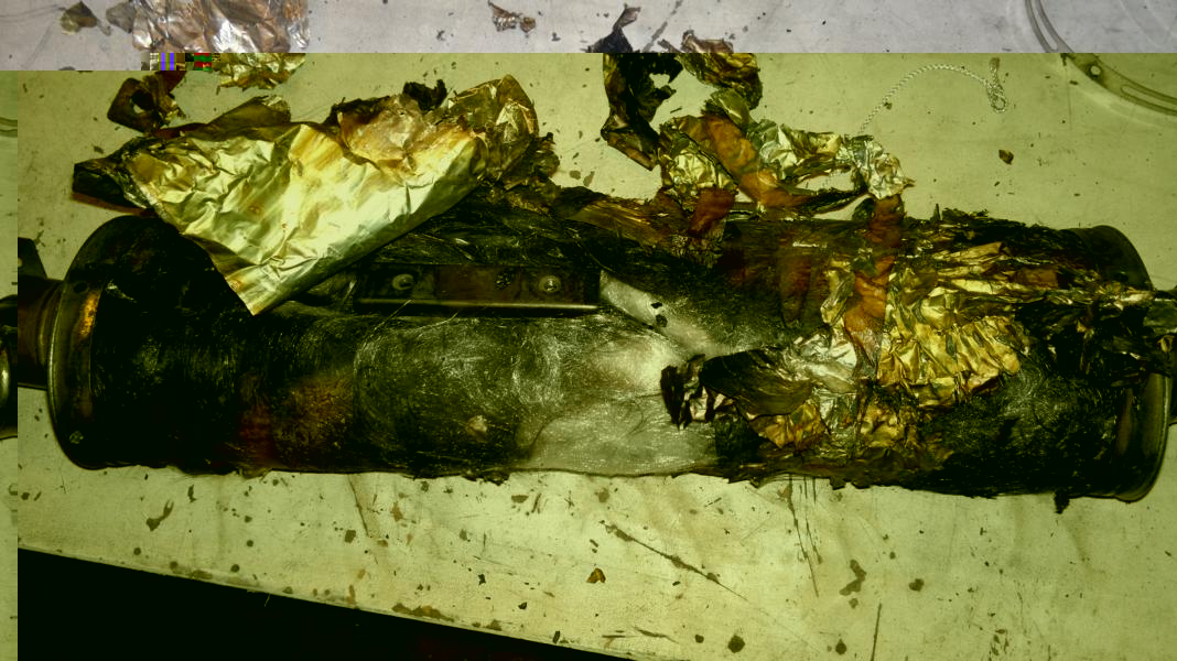

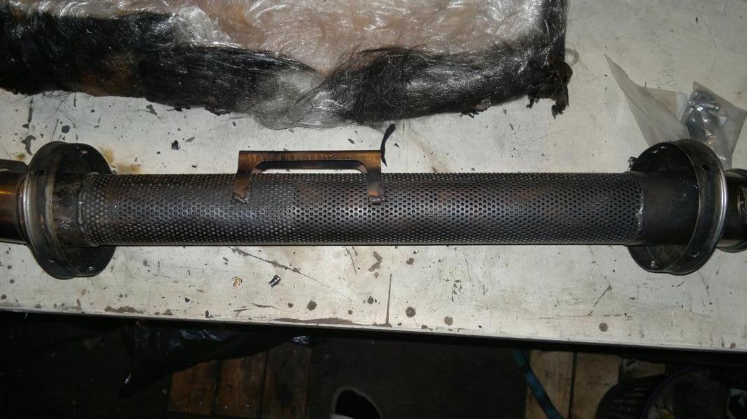

Just giving a short status w. some pictures.
I did a little progress the last days.
My exhaust cans are ready.
The old titanium tubes had dents and were not nice looking any more.
I replaced them w. carbon fibre tubes.
I tried some hours to get the damn thing open, after drilling the rivets nothing happend.
So i cut the tube. Thats what it looked like iside: And this is why i could not open it. The endcaps are welded on the center tube... (Marving)

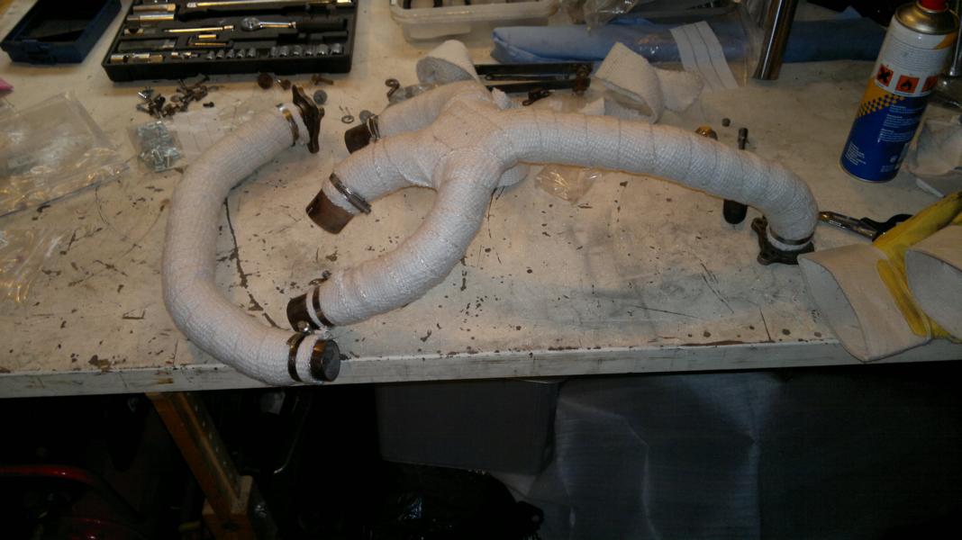

And here the result:
Then is was the headers` turn. They are good, but not good looking and too much heat emitting on the reat Wilbers damper and also heating up the space in the fairing.
Thats why i wrapped them in ceramic fiber cloth:

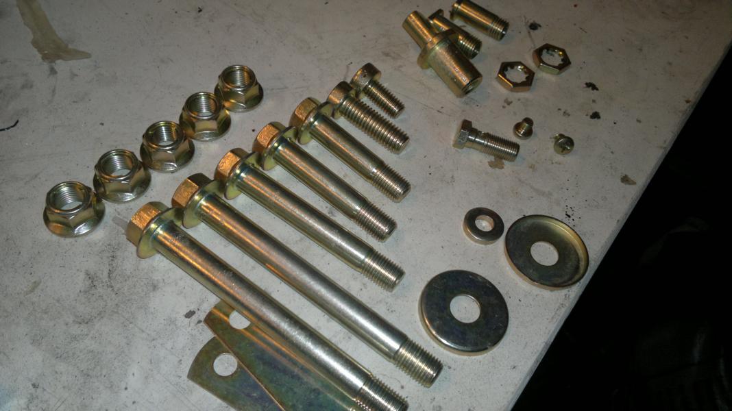

I received my zinc-plated swingarm bolts and some other parts last week.
So i started with the (4th) reassemblyof the swingarm & rear monoshock.
The new mudguard, etc... All parts, screws, bolts, nuts, plastic & rubber parts are new, new zinc-plated or painted. (except the connecting rods) Some parts i used were the the last available.
You can see some dust on the parts, i can not avoid that...
