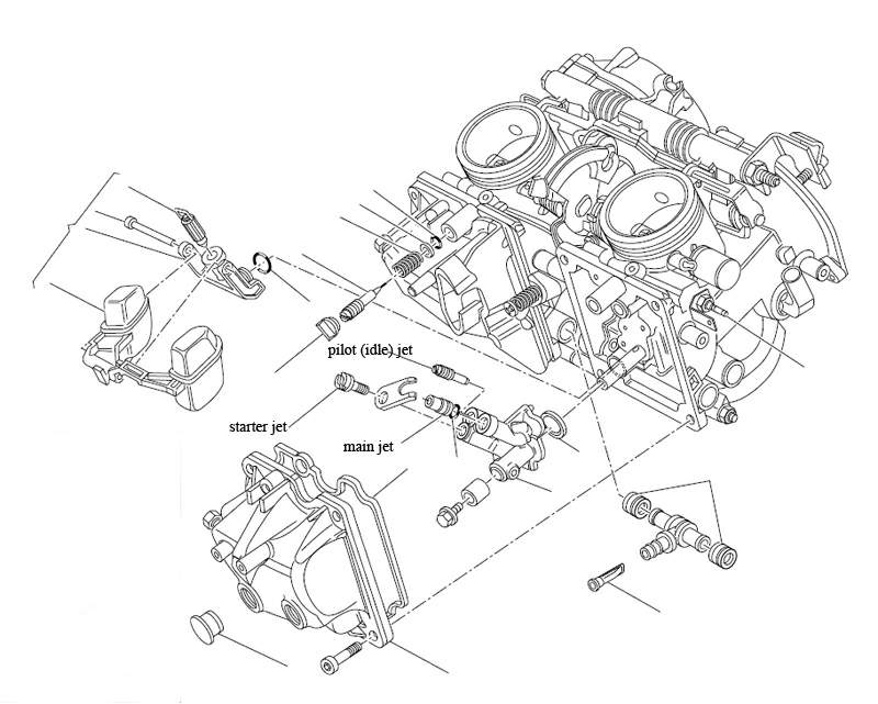

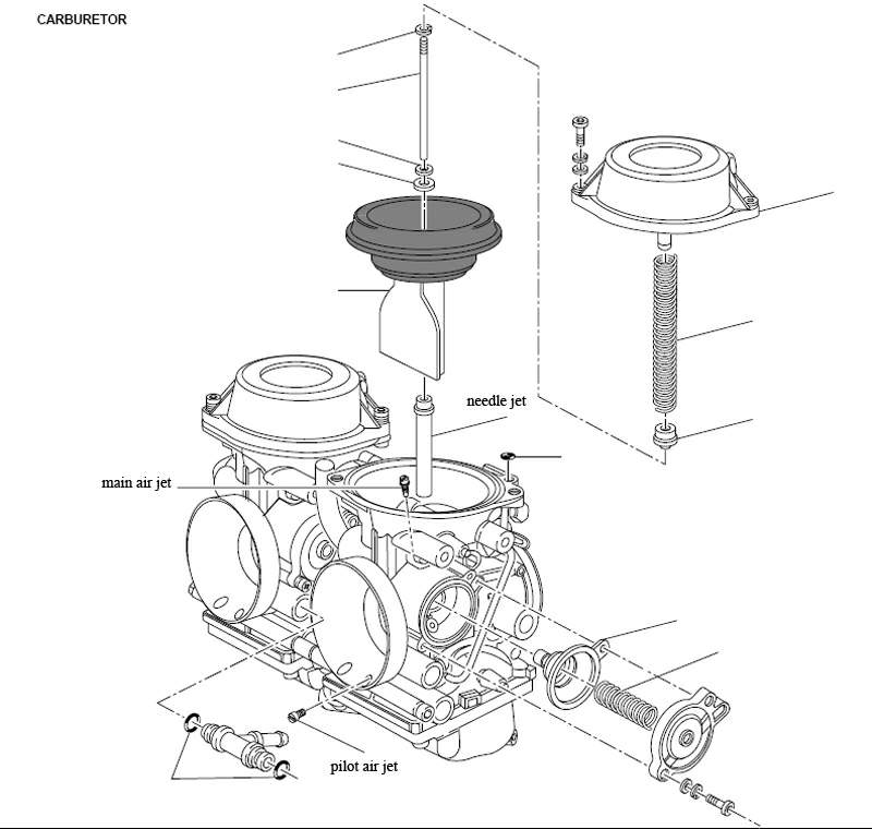

You will have to remove your Mikuni and disassemble it to check the complete jetting you currently have.
To get to the needle jet you remove the nut marked red and push it out (with the grey plastic part)
With the K&N filter you`re using and the Gio.Ca.Moto 2in1 exhaust neither the 750 nor the 900SS jetting will be completely right and can only serve as a starting point. I guess I`d use the 900SS jetting for reference in your case and go from there, so with a larger main and pilot jet and new jet needles.
Important to prevent leak air of course is to use good rubber boots (the connections between the Mikuni and the carburettor manifolds), to use paper gaskets between the carb manifolds and the cylinder heads and to close the the hose nipple connections on your carb manifolds if these are not used (with a small screw and copper washer).

Hola de nuevo,ademas el "nedle jet" es el mismo en todos según los datos que me dices( Y2) por lo que debere solo cambiarle las agujas a unas 5c19...ya que supongo que el "Y2" es valido para ellas.
Tebgo una cuaestion que preguntarte...los "main air jet" y "pilot jet" cuales son exactamente..? me los señalas en el dibujo,por favor? realmente al desmontar el carburador,no todas las piezas tienen señalada su medida, llevan numeros de serie internos que no corresponden con la medida,asi que uso calibrador para medirlo..
Pero si me señalas en el dibujo esas partes me sera menos divicil comprobar sus medidas
