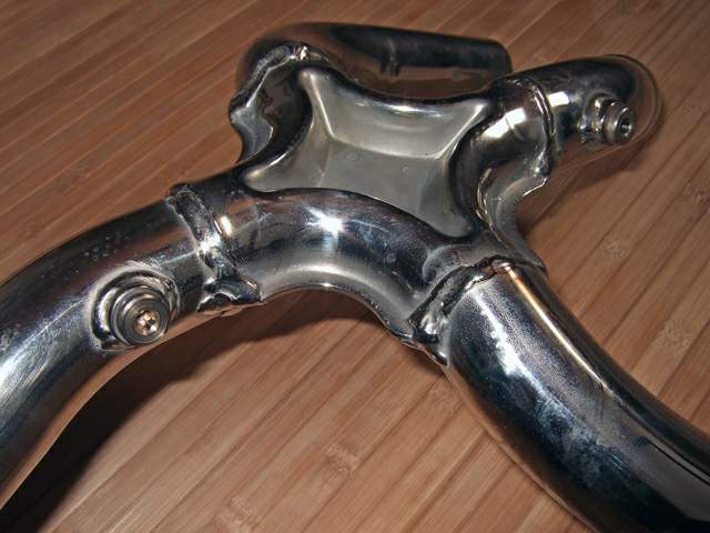

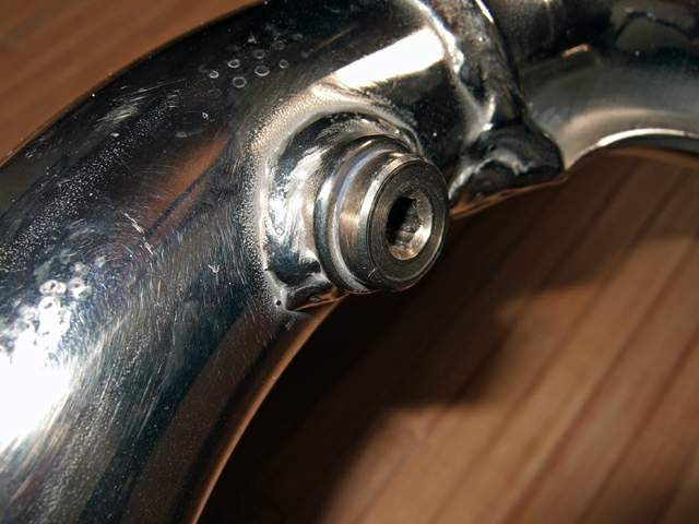

So, I bought these new headers on the internet. they have these threaded holes in them (pictured above) which my original did not have.
My original had a hole in it, that's why I needed a new one :) but not threaded....
Any ideas?

some headers had connections for a gas analyzer.
The thread should be a R1/8 (conical).
The old plugs were #000047113 (now 78010091A). Not sure if #78010071A is the same.

thanks. conical thread huh... the things you learn...

got the washers, too? Applying some anti-seize is recommended.

paso750 wrote:got the washers, too? Applying some anti-seize is recommended.
I was wondering about washers. are they special? or would the right size washer do?
Re: threaded holes in my new headers?
use a copper washer
Pablo The Squirrel
Posts: 22
Joined: Sun Feb 20, 2011 3:35 am
Location: New Zealand
Post by Pablo The Squirrel »
paso750 wrote:use a copper washer
can't find copper. will brass work do you think? the plugs are brass
that should be ok, too. It should just be a washer that also can seal.
aluminum will work and are readily available

paso750 wrote:that should be ok, too. It should just be a washer that also can seal.
I don't understand "that can seal"
you want that bolt to sit airtight so you use a washer made out of a softer material than steel
