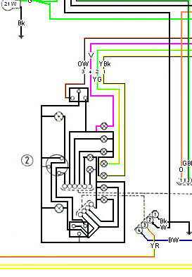

The only thing I can see that will fit all these symptoms is the 4 pin connector has popped out of the back of the dash.

Re: Dashboard Died
Nah! If it was simply a ground the neutral light, oil light, side stand light and generator warning light would all still work.higgy wrote:The only thing I can see that will fit all these symptoms is the 4 pin connector has popped out of the back of the dash.

Re: Dashboard Died
- 907_dash_zpsdjmiuqpo.jpg (46.3 KiB) Viewed 28813 times
