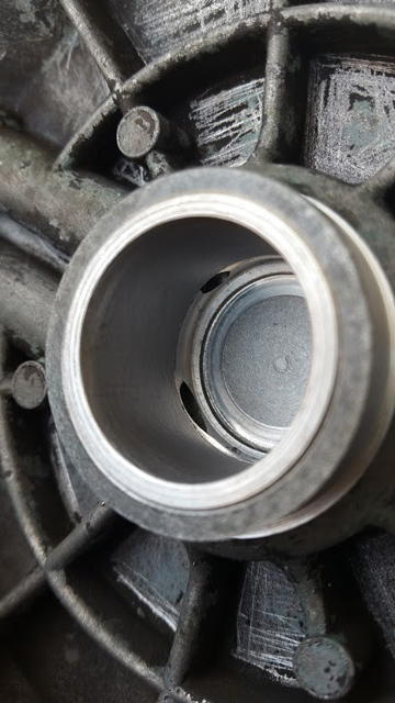

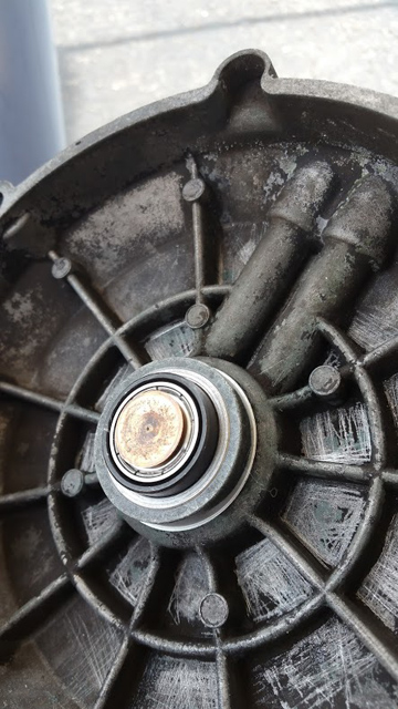

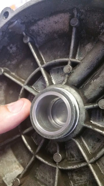

So I can report that while the sleeve job appears to have been done well, it seems that during the process, it created a crack (or two) in the fluid channels of the cover. I had a steel sleeve inserted, and they were able to remove bore material right down to the fluid channel that exists at the bottom of the bore (you can feel it if you run your finger around the bottom of the bore). They did a fantastic job with the over-bore and sleeve. However, upon reinstalling it, I was never able to build up pressure in the lever, and somehow the cover was weeping fluid.
Since I couldn't see the source while it was on the bike, I pulled the cover, line & master and made a jig on my bench so I could bleed it up there, clamping the piston into place to simulate it being on the bike. I dried the inside of the cover and lo & behold, once I got the air out, any pressure in the system would cause a weep through a crack, possibly two. It appears to be in between the fluid inlet channel (from the hose) and the air bleed channel; possibly another towards the bottom - neither of which are easily visible.
Since this wasn't happening prior to the 'surgery', I have to assume it was some artifact of the sleeving process. I was considering trying to thoroughly scrub the interior of the cover and use some JB Weld for aluminum to see if I could patch it, but I don't know how well that would stand up to the heat+vibration+continuous fluid pressure changes. I just get the feeling I'd wind up on the side of the road without a clutch at some point. So I've sourced another used cover, and I'm going to go with that.
I feel like I'm exchanging the devil I know for the devil I don't, but hopefully it'll mean the bike will be reliably back on the road in short order. Worst case, this new-to-me cover needs a sleeve; and quite possibly I'd give that a second shot. My shop only charged me $100 to do the sleeve. (The crack may have just been an unfortunate occurrence; I've got ~30k miles on my Paso, and it's had a workout for most of that.) Not that I'm thrilled about the cracked fluid channels, but as it's been nearly a year since I had the work done, I'm just going to let it go. I had so much trouble with the clutch over the past year, and the year prior, I wound up just letting it collect dust until this year. (Which only gave the mice ample time to make a formidable nest behind the seat, just above the rear light ... so the bike also got some wiring upgrades this summer, too).
But, here's pictures of the new steel sleeve ... prior to having clutch fluid leak all over it.
With any luck, the new cover will solve all of this ... so much for 'fixing' it.
