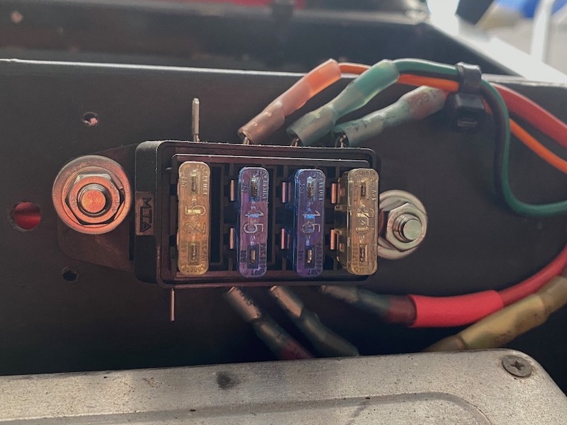

Anyone ever replace the fuse block on a 907? Mine is falling apart. Literally crumbling. Whatever the material is, it was not made to withstand the test of time.
Does anyone have a good aftermarket replacement for that item? I did order one for marine application, but it is a little large. It may work, and is high quality, but I think I will look for one closer to the original size.
Thanks

Eastern beaver has some good ones

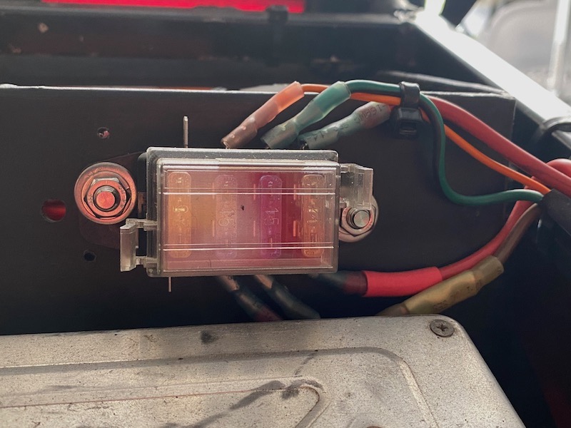

When mine fell apart I used a Narva 54420BL. I used insulated spade connectors and bent the terminals a bit for clearance.
