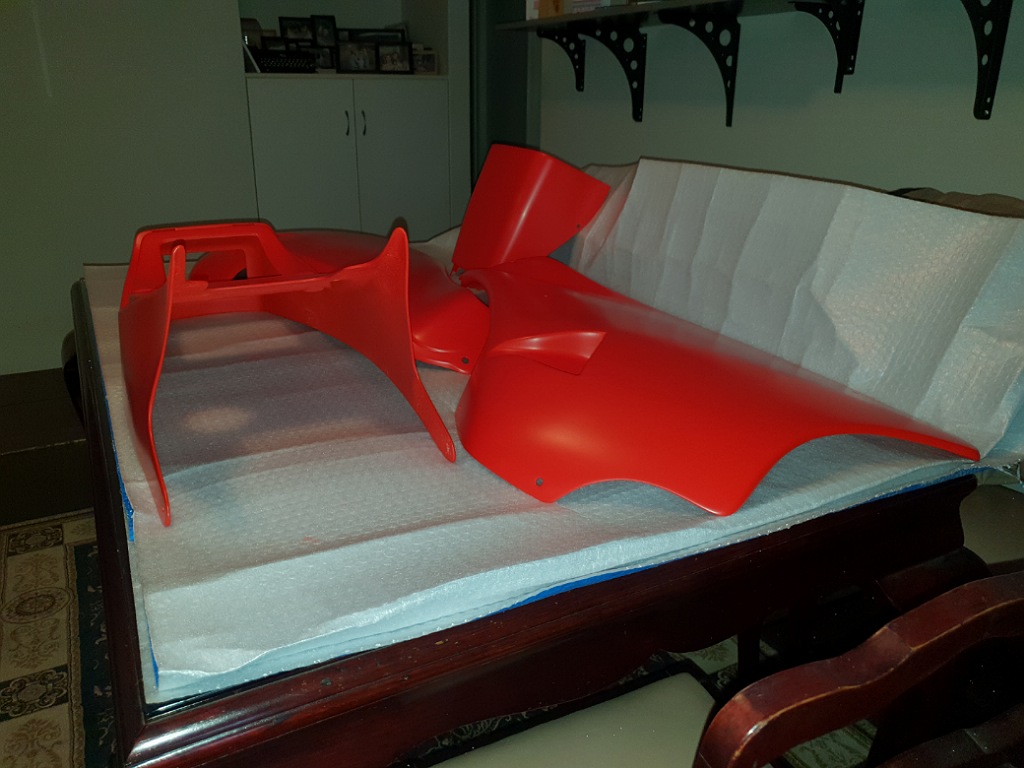

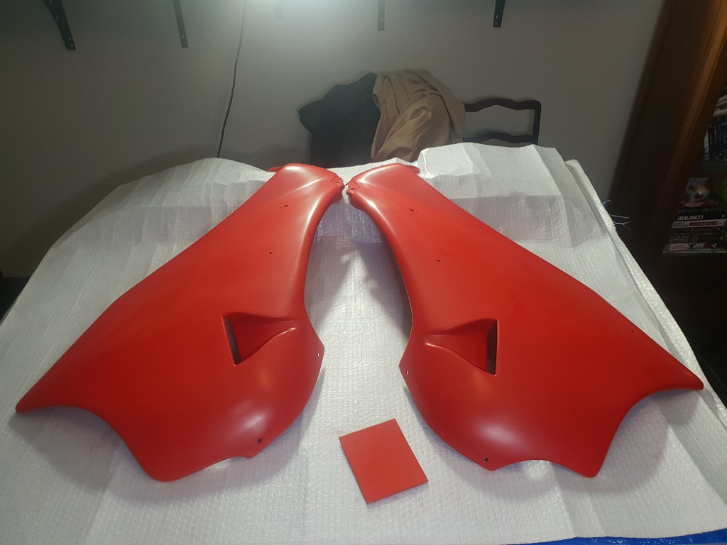

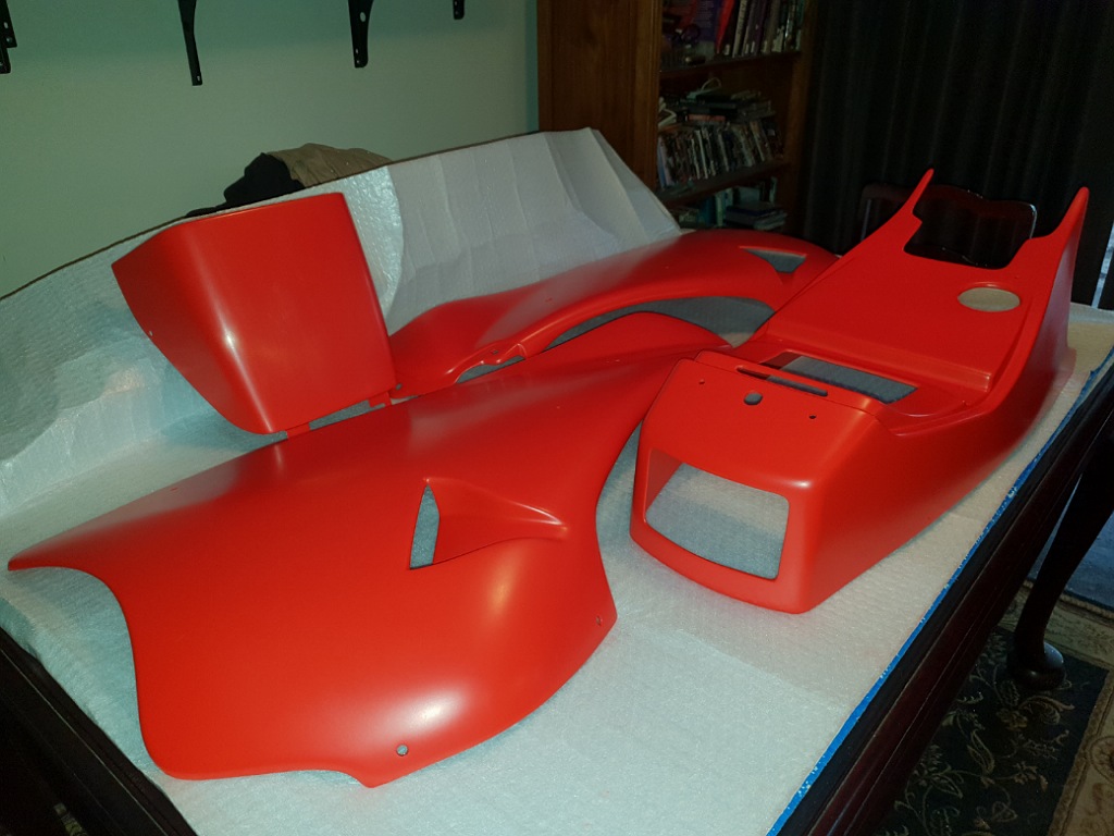

Well I have very lightly denibbed all the panels but again I'm finding more pinholes and a little primer showing on some edges on different bits .the finer sanding brings out all the really small stuff , it now sort of depends if I can be bothered with going through the knifing putty, reprime and red on all those little bits.i will because the way I see it I've put so much work in already it'd be a shame not to. I have only used the one sanding pad on all the parts, so far to give you an idea of how lightly I'm sanding this technically last prep before the clearcoat

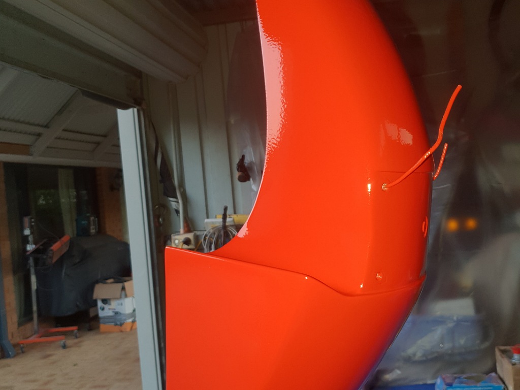

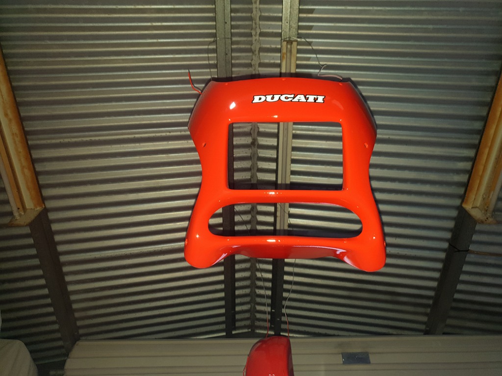

Now it's ready for clearcoat, fair bit of mucking around but that last little effort has made the difference.

HIGHWAY89
Posts: 637
Re: Oil leaks 89 900 ss
Post by HIGHWAY89 »

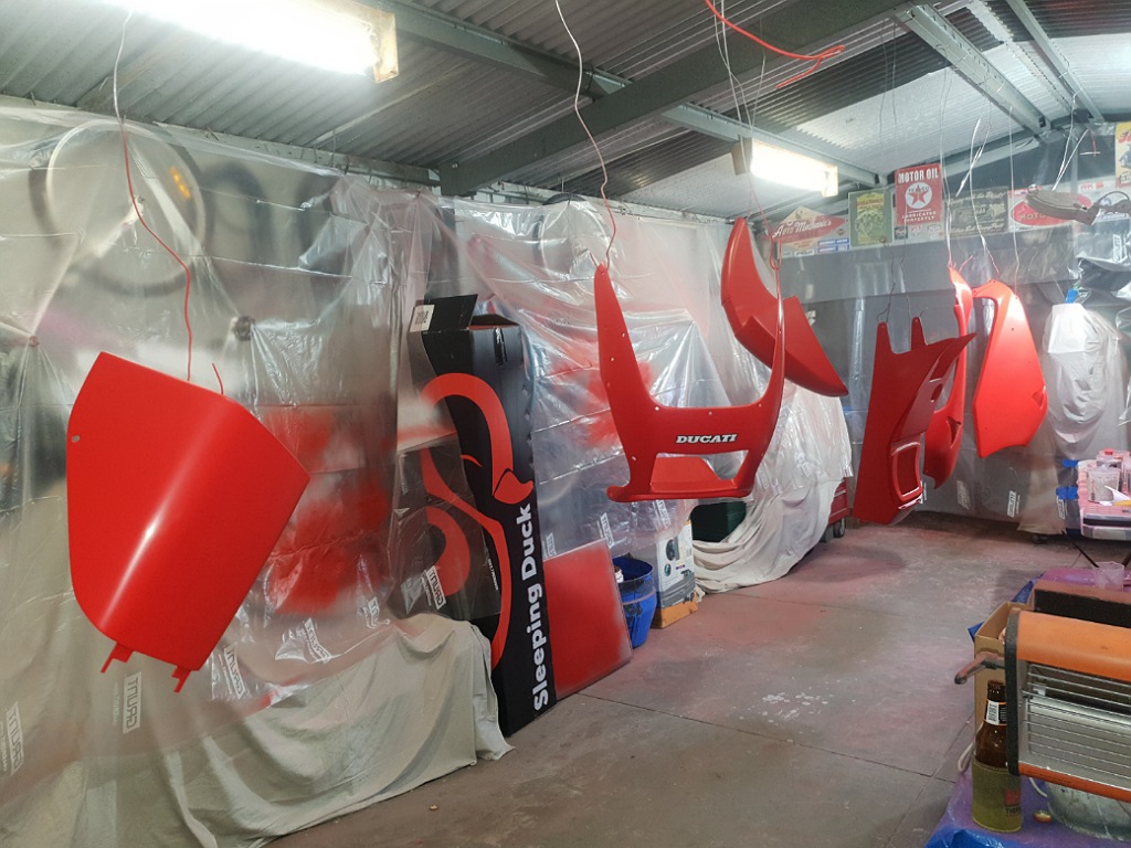

Thanks Tamburinifan, yeah lighting is one of the biggest problems, for that last fill, sand and reprime some spots before the last basecoat, I did a lot of the prep on that table in my dining room with some lights from the shed as well, but spraying in my shed setup the way it is ,is damn hard to see it as well as I'd like

Turns out I needed to clearcoat within maximum 24 hours after , I missed that window and now I'll have to lay I more coat red and then straight away put the clearcoat on, I really should have been more prepared. I had run out of thinners and didn't have enough to clear, so big thing there is you really need to clear straight after your final basecoat,no denibbing unless necessary and no sanding between clearcoats, so now I'm going to have 1 more coat than I'd like

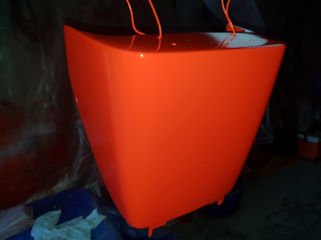

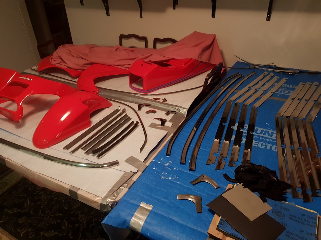

I have applied an extra coat red and now clear coated these parts, the clear came out quite orangepeely, it can wait now to harden before I sort it out as I need to clean this stainless steel trim off an EH holden for a customer, a long slow process. Unfortunately my dad has suffered some form of brain trauma through anaesthetic for a knee replacement and I'm really going to struggle to keep on target for a xmas finish. I will just plug away when I can .

No real forward movement on the bike, but I'm fairly advanced on the stainless, then I can look at the bike again
