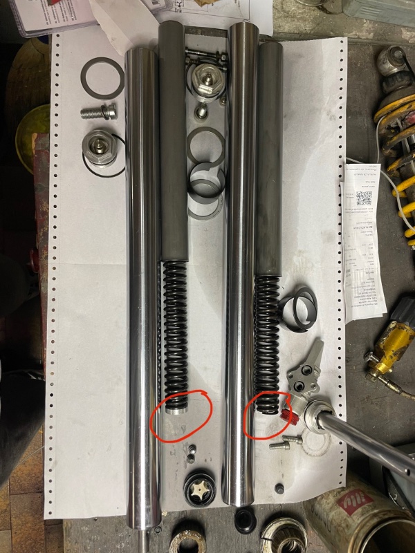

I dissasembled the bike. Frame is off to sand blasting. And now i started working on suspension. I dissasembled front fork and i think that i’m missing part circled on the photo. I’s missing in the leg with rebound adjustmend. Am i correct? If so does anybody have this part for sale or at least fork dissasembled so that can take some measurements.

The Marzocchi M1R manual shows a "ferrule" for each spring, suggesting someone's been in there before ...

I checked manual. Problem is that it's different than in other leg. That's whay i'm searching for one or at least some measurements that i can make one

The parts catalogs are not 100% reliable. It's possible that early M1R forks had that "ferrule" in both legs and later didn't. If you look at the 906 parts catalog (which was probably printed some time after the one of the P750), it shows that part only in the left fork leg. If that Öhlins is originally from your Paso it's an early one in which case by my own theory the fork should have those pieces on both sides.
But as Murphus said someone else may have rebuilt the forks in the past and forgot to put it back in. Or the factory did or it's not the original fork anymore.
What's the stanchion tube length?

Looks like there is no spacer in one leg. I managed to get another forks and also therre was no spacer.

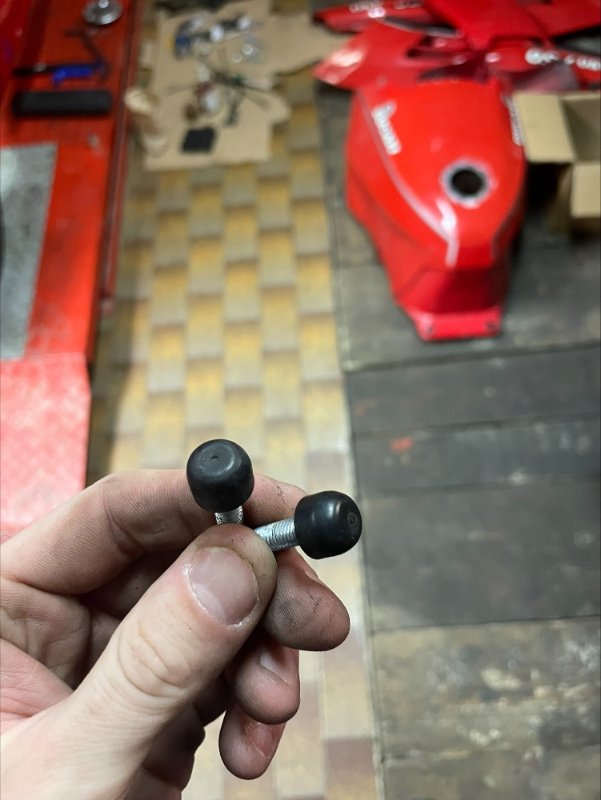

Currently waiting for wheels send them for fresh diamond cut. Now i have to start working on fairings. Still searching for recomendation where to get stickers. also does anybody know where theese two bolts came from? can't remember from where i removed them.

Those two bolts don't look like anything from a Paso. Did you remove the two bolts from the lower triple clamp, maybe. The ones that adjust how far the fork can be turned to left or right?

paso750 wrote: Mon Dec 18, 2023 9:01 am Those two bolts don't look like anything from a Paso. Did you remove the two bolts from the lower triple clamp, maybe. The ones that adjust how far the fork can be turned to left or right?
I also tought that i removed them from steering stops. But there is no adjustable steering stops on paso.
I removed them from paso because i was doing dissasembly in my new workshop that was compleatly empty even without workshop equipement should take more photos next time
Posts: 1553

Two bolts from front tank rest? Don't remember what they look like.
Re: Ducati Paso 750 complete restoration
On mine there are. I always thought those were original but maybe one of the past owners drilled the holes and fitted adjustment bolts.
Could it be the bolts to mount the brake line splitter in front of the lower triple clamp?
Posts: 2004
Well I was going to agree with G about being non paso , but I got a feeling I have seen them before ......and I have a Paso in bits so .... coincidence ?
Maybe from around headlight mounting subframe area , buffers ?

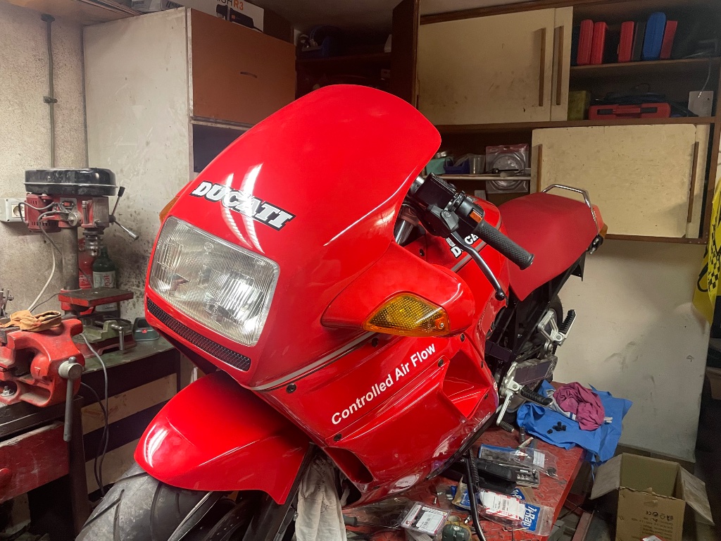

Me again.
Rebuild is slowly coming to the and in i can not figure it out how to install front fairing to the bike i tried from the front from the top,… just can,t figure it out and i do t want to strech it so that i don’t crack the fairing. Is there any video available of installing/removing front fairing
