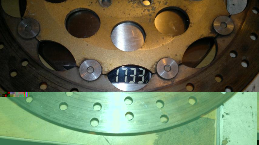

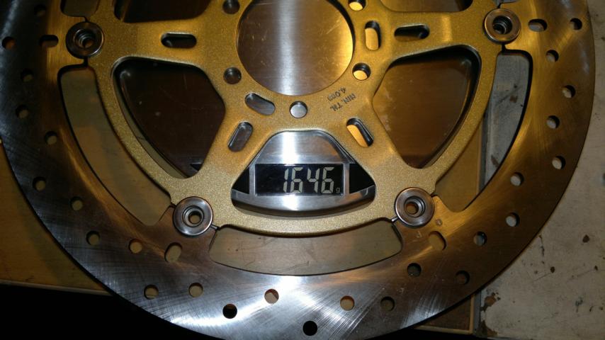

But the new front discs are lighter.

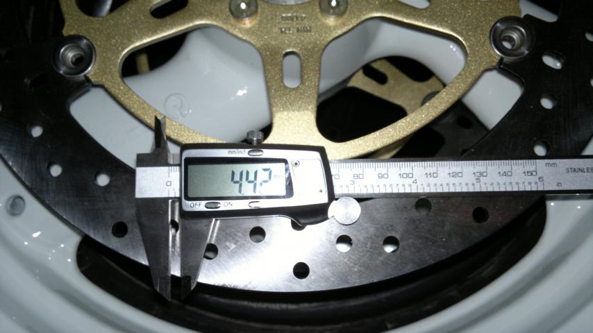

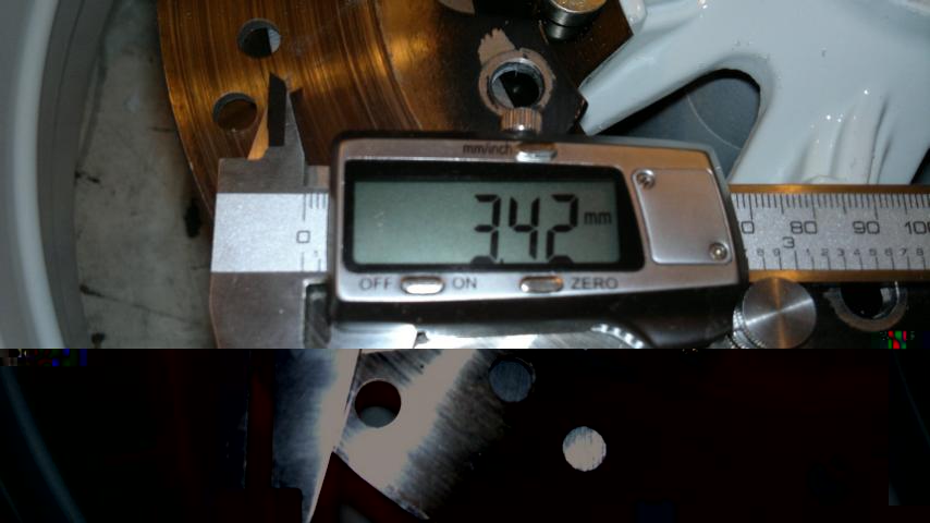

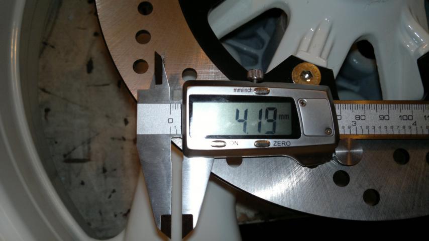

Let`s have a look at the thickness/wear of the rear disc:
- 18092011331.JPG (55.37 KiB) Viewed 8414 times
- 18092011340.JPG (52.07 KiB) Viewed 8691 times
- 18092011339.JPG (50.98 KiB) Viewed 8691 times

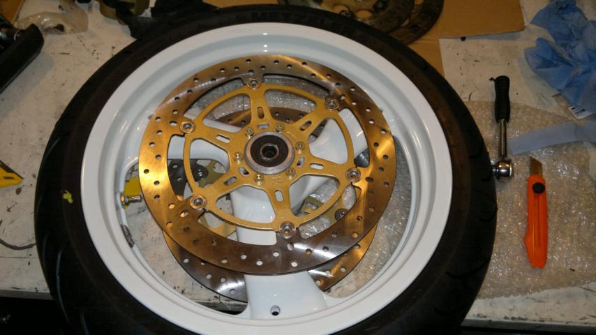

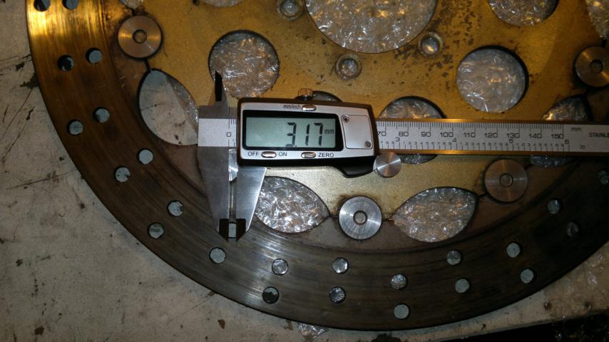

And the front discs:
- 18092011343.JPG (69.05 KiB) Viewed 8691 times
- 18092011342.JPG (58.24 KiB) Viewed 8691 times
86` Ducati 750 Paso
96` Cagiva 750 AC Elefant
86` Ducati 750 Paso
- JoKing
- Posts: 362
Re: Rebuilding my 907 ST3
I think i had a little too much wear on my front disks...

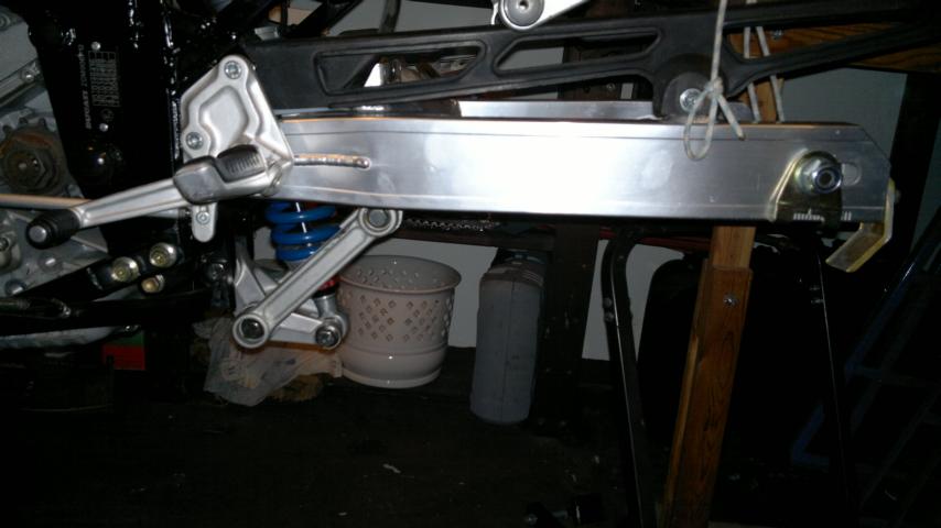

Now the new swingarm is in place as well.
But there are two open issues with it:
The decals are still in production process, & i need all the bolts for the shock and so on new or to be zinc plated...

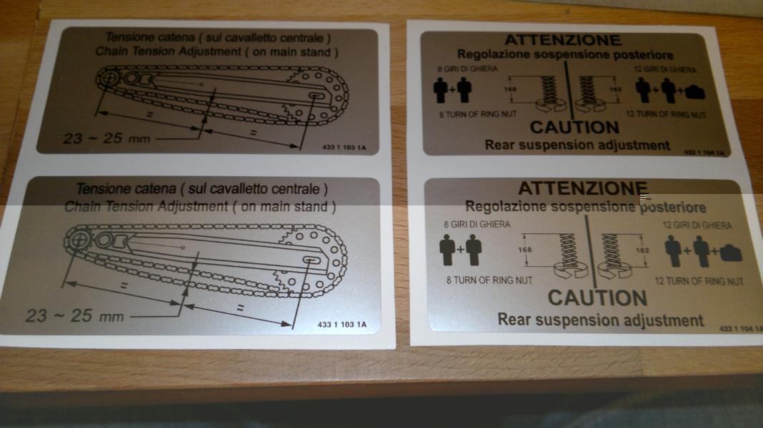

Without the black frame, but finally some decals arrived!
Watch this!:
Watch this!:

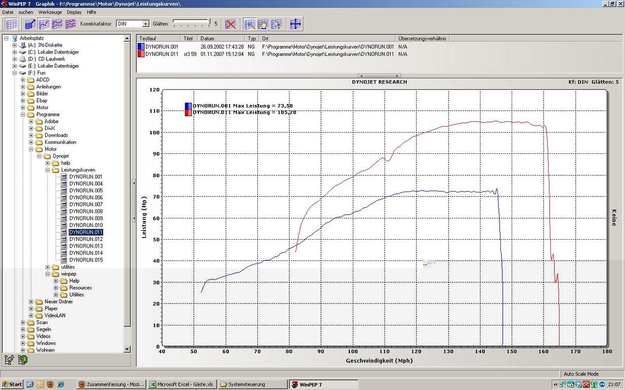

Look what i have found in my archive!
This is rear wheel power... I can`t wait to have this one back on the road.

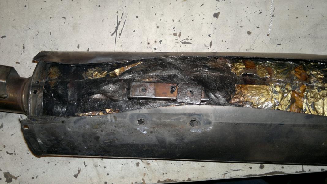

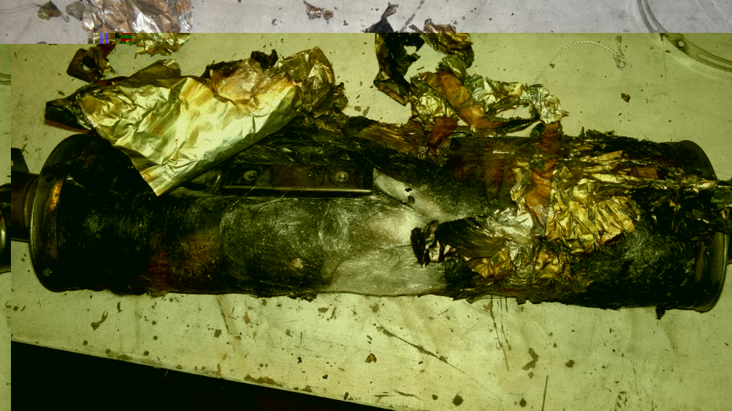

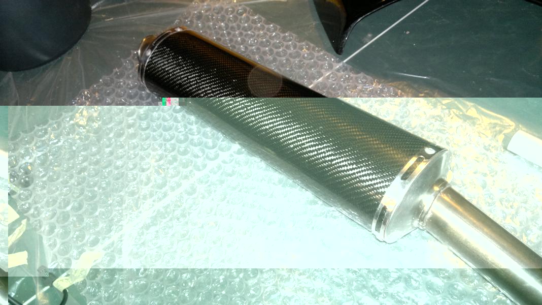

Just giving a short status w. some pictures.
I did a little progress the last days.

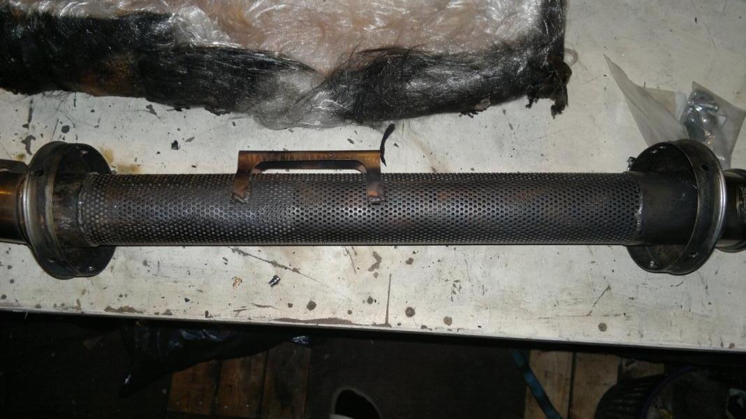

My exhaust cans are ready.
The old titanium tubes had dents and were not nice looking any more.
I replaced them w. carbon fibre tubes.
I tried some hours to get the damn thing open, after drilling the rivets nothing happend.
So i cut the tube. Thats what it looked like iside: And this is why i could not open it. The endcaps are welded on the center tube... (Marving)

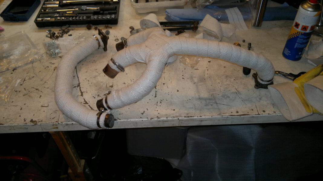

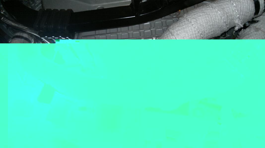

And here the result:
Then is was the headers` turn. They are good, but not good looking and too much heat emitting on the reat Wilbers damper and also heating up the space in the fairing.
Thats why i wrapped them in ceramic fiber cloth:

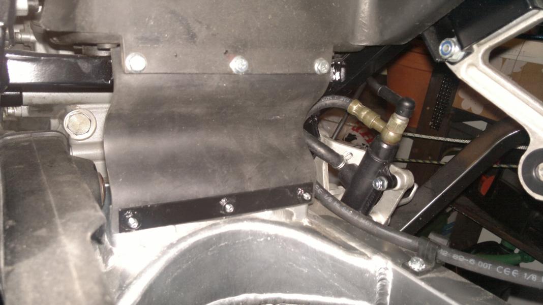

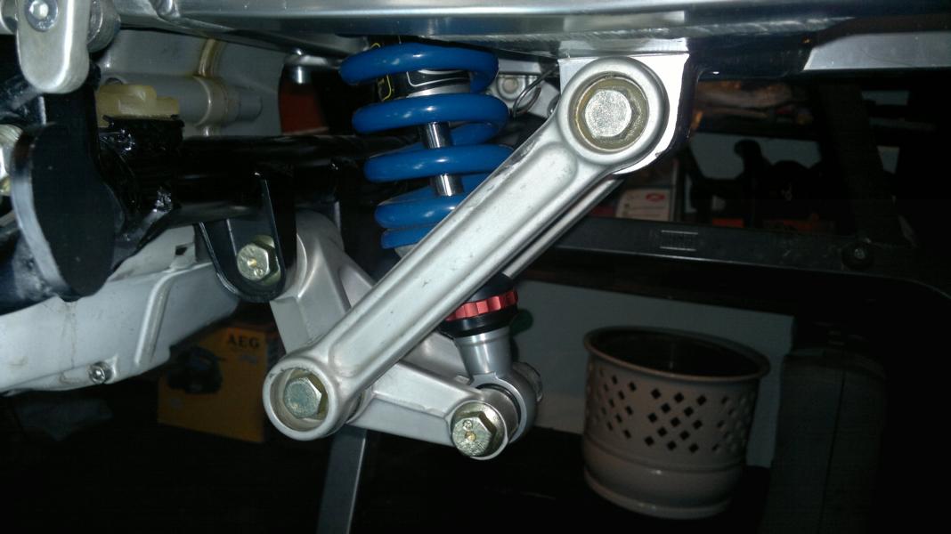

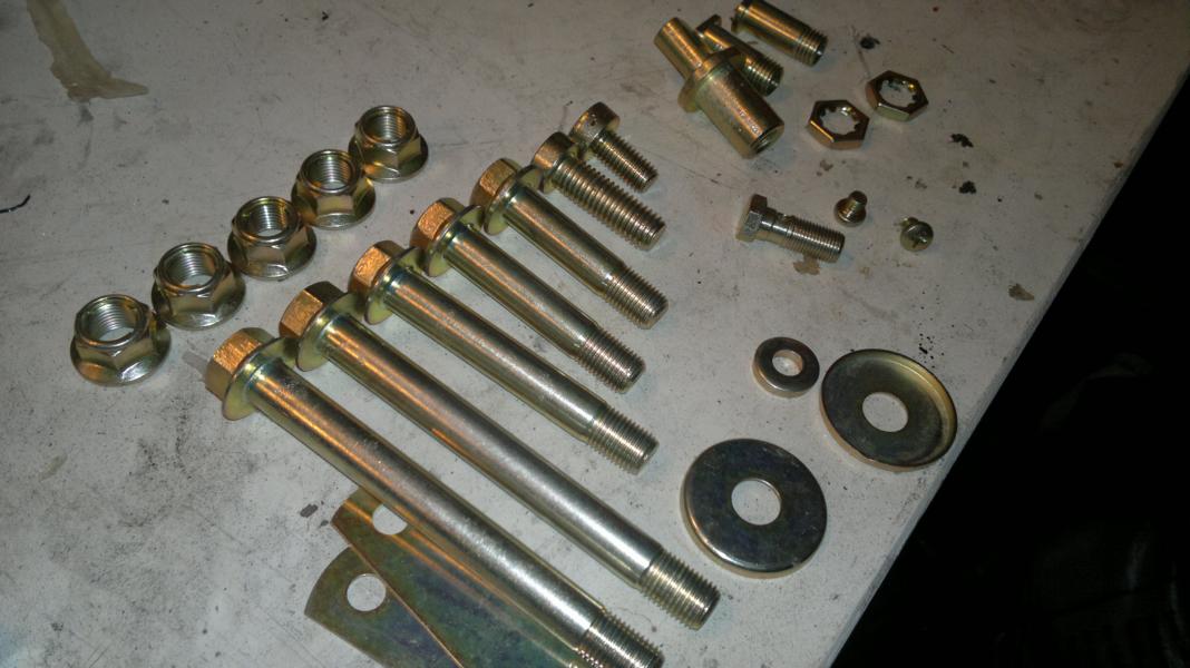

I received my zinc-plated swingarm bolts and some other parts last week.
So i started with the (4th) reassemblyof the swingarm & rear monoshock.
The new mudguard, etc... All parts, screws, bolts, nuts, plastic & rubber parts are new, new zinc-plated or painted. (except the connecting rods) Some parts i used were the the last available.
You can see some dust on the parts, i can not avoid that...
