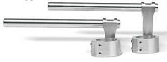

Yes i thought about the clipons. They are from a 916 (risers) that part is ok, the only problem now is the tank.
Are these mounted above or below the triple clamp ? I have some aftermarket parts from LUCAS. You can change the piece between clamp and bar to adjust the height of the bar. (similar to these)

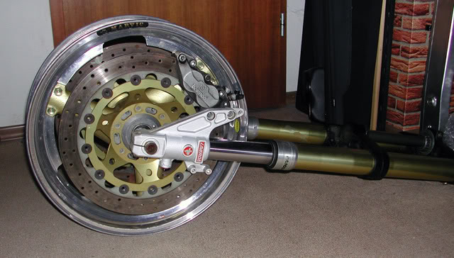

Here`s my Paioli fork. The 16" Marvic rim is almost covered by the 320mm brake disc :mrgreen: I will try to keep the Paso front fender as I want the overall look to be original.

as you can see on my new added pics, the risers are mounted under the upper triple.
I still don't think that it comes high enough, but otherwise i will put the old ones on ebay and buy higher risers from ebay.

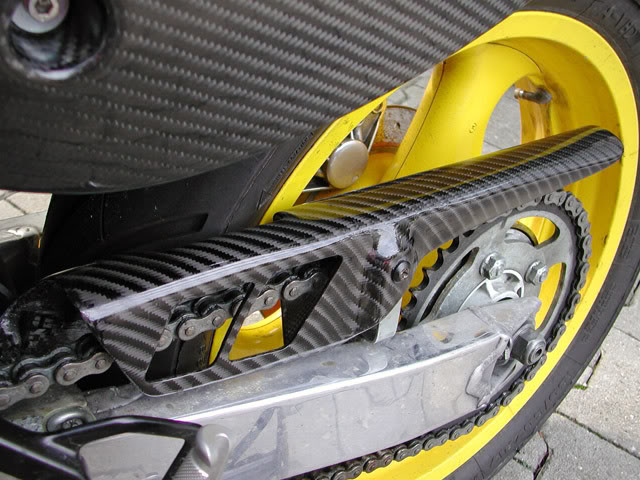

I did a lot with CFK the past years. (ie the chainguard of my Gilera and the Pasos airbox)
I`m sure it`s not necessary to build a new tank. Also there would be many problems like making the thread for the petcock. Stefano had a tank made of glassfibre but then had an alloy tank made as the glassfibre one kept leaking.
(for CFK work there`s also clear epoxy resin, not only the yellowish and blueish one btw.)

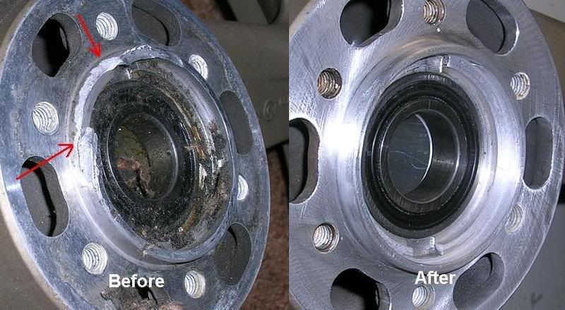

Then the wheels, they are from a 750ss (17x4,5) rear and you have to cut out the hole for the bearring with 1 mm. around.
So the diameter is 2 mm. bigger to let the bearring fit.
This is because the 750ss rear axle is 17mm and is related to this bearring with 40mm. outside diameter.
They told me that a bearring with outside diameter 40mm. and inside dia. 20mm. does not exist (at the skf dealer), so i have to cut out.
That is a secure job but not mission impossible.
Ok thats it for now, hope someone can do something with the information.
ab. :thumbup:

Beautiful texture & finish on your carbon, G. :thumbup:
You take orders? :)

zap wrote:Then the wheels, they are from a 750ss (17x4,5) rear and you have to cut out the hole for the bearring with 1 mm. around.
Are you saying that you want to run a wheel that is for a 17mm with an axle that is 20mm, correct?
You are correct that SKF doesn't show a bearing that has a 20mm ID and a 40mm OD. If you plan on reaming out the hub another 2mm to use a 20mm x 40mm bearing, you're probably looking to use a 63004-2RS bearing (16mm wide) or any of the 2004-2RS varients (12mm wide).
Here's the SKF bearing table for those bearings...
http://www.skf.com/skf/productcatalogue ... tartnum=12
Machining the hub for the 40mm OD bearings shouldn't be an issue. Worse thing you may have to do is take it to a machine shop and have it done. I bought a spare set of wheels for my ST2 and they were damaged in shipping. The rear wheel's sprocket carrier broke off a section of the lip where the seal goes on the front wheel. I had to get it welded and machined back down. It came out very nice and cost $75 USD for the welding and machining. I'm sure reaming the hub for the larger bearing would come out just as nice, and probably cheaper since it only needs to be machined....

I will order the 42 mm. bearrings (20mm. inside)
There are a few honing tools available to do the job myself, but i think this can be done more accurate by a pro.
There are several machinists in my area that can do it, and i'm doing some research at the moment for prices. :phone:
:beer: cheers, ab.
