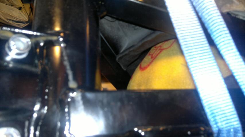

pic 1:
Fitted w. "no toil"-like airfilter. The "dirty" look comes from the blueish filter oil.

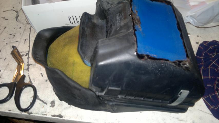

pic 2:
lower part "installed"

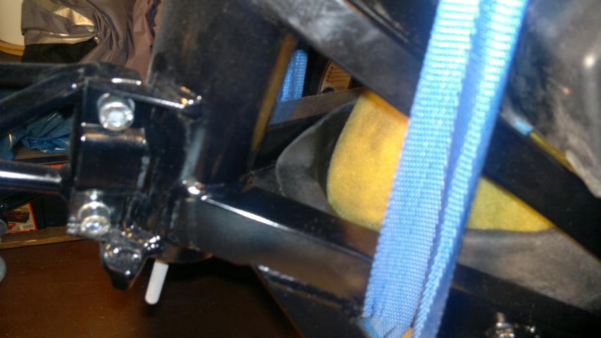

pic 3:
fits nice

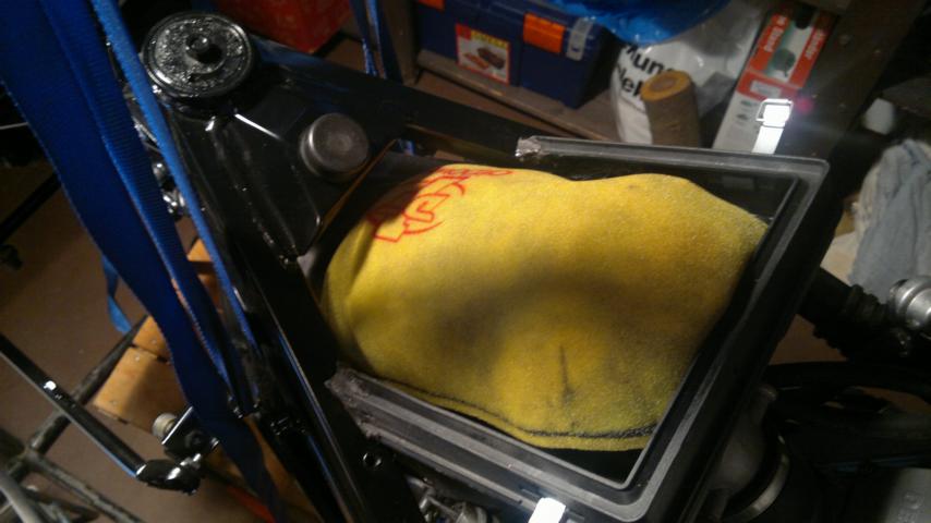

pic 1:
view from above w. top of irbox fitted

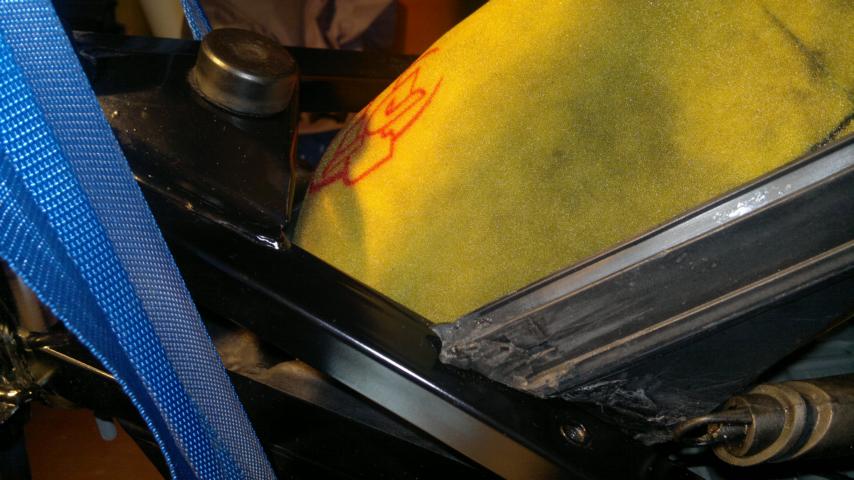

pic 2:
lower "lid" of the opening fits to frame
pic 3:
upper "lid" of the opening fits to frame. The frame triangle behind the steering head is used as a part of the airbox this way. (see also pic 1)
Maybe the opening is too large, but we will see.
