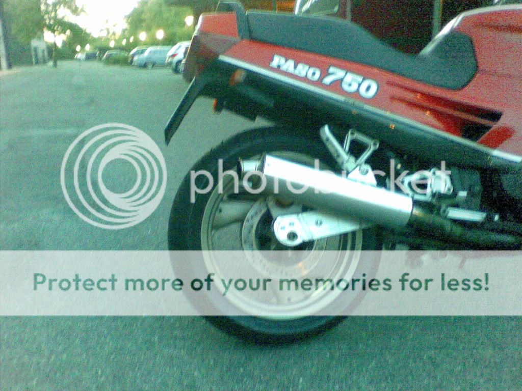

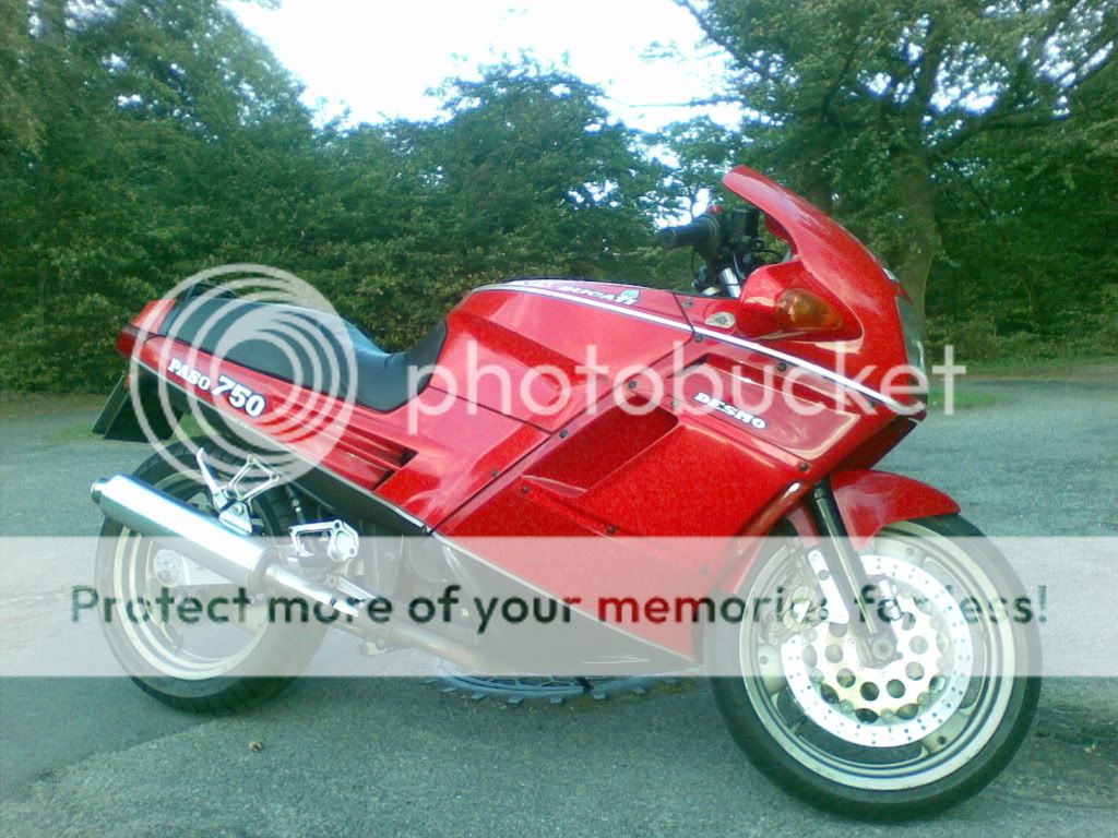

I am pretty pleased with the result. I only need a new chain to fit the bigger rear toothed sprocket. More pictures will be added for the end result.

What wheel package did you use? Looks like the stock swingarm.

Wheels are from a 600 ss with a 17 mm shaft, front and rear. It was not possible to use the old shaft, because of there are no bearings there will fit in the wheel Ø 40 mm with a 20 mm haft, so I used the ss 17 mm shaft and got made a pair of new excentrics http://www.bikepics.com/pictures/1233491/ .

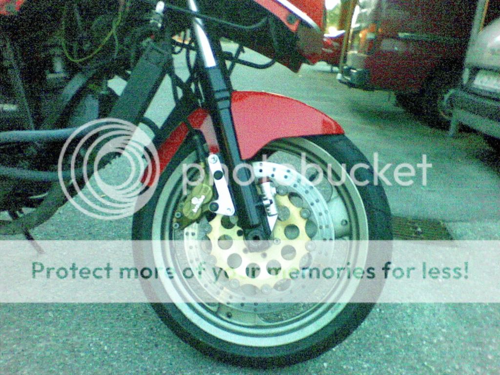

You'll need to raise the front mudguard 1/4"
No more than this or it will grind on the side panels! :,(
An option would have been to machine the hub diameter of the rim from 40 to 42mm and use standard size Paso wheel bearings SKF #63004-2RS or to get a 907ies swingarm of course. Then you also wouldn`t have to modify the swingarm to add the pin that holds the brake caliper bracket.

Machining the hub I also thought of doing, but you need the holes to align neatly. I think this was the best solution by making new eccentrics. If you want to reuse the pin for the caliper bracket, you will have to make a new bracket. I just drilled a hole in the swing arm, inserted a metal tube and a bolt for the pin, and used a bracket from a ss.

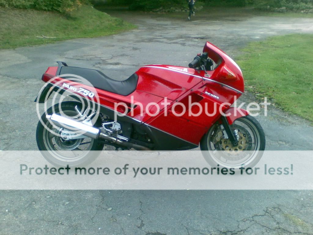

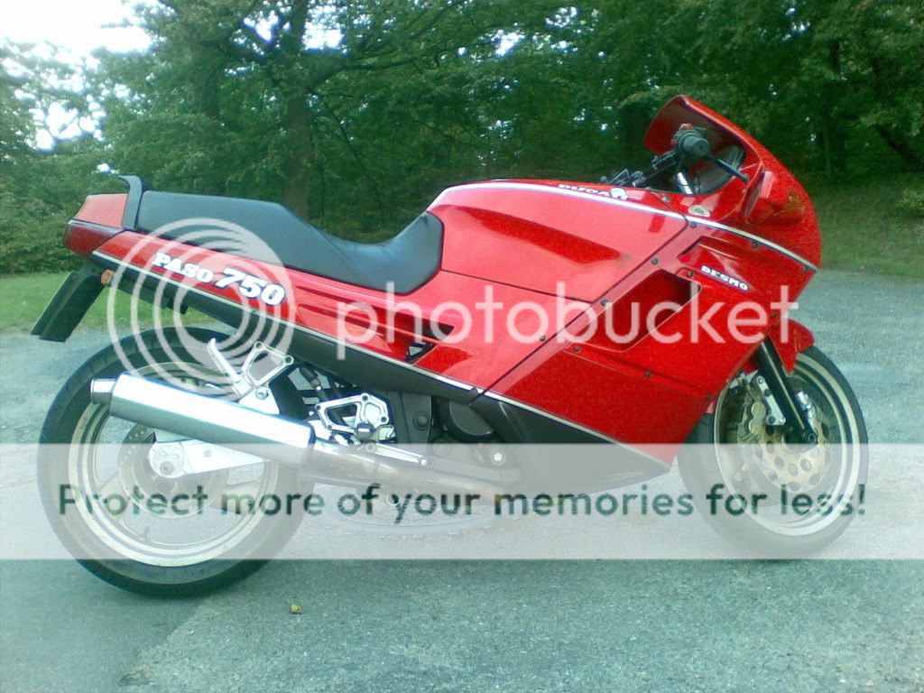

Fairing mounted. Nice ride and pleased with the looks :beer:
Before:
After:

Very nice,looks a little stuffed up front :o

:D Jep, there's not much room , but no contact :)

Nilaus, can you make some new mail with links and all details about Your 17" conversion, as here are many guys, who are intrested of such.... I visited your web page and there was good drawing about rear axle adjuster, but unfortunately my printer didnt show so clearly those measurements(mm) Very good job from You! :beer:
What You think about front braking now? I changed to 4 piston Brembos in my 750 Paso and it was amazing that difference to old 2 piston system, ....never back to 2 piston calipers anymore!.... :smoke: Have You drawing about adapters? How about front axle? Bearings? Chain line(offfset)? any problems? all is welcome surely... :beer:
