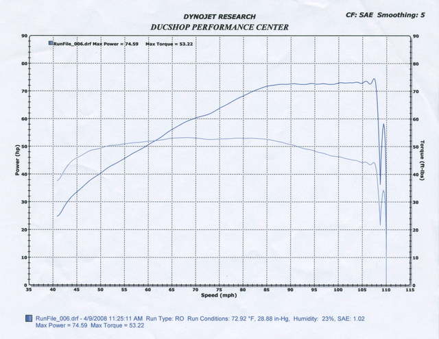

I have two Dynocharts. I think one came from the forum and one I found in the internet. Both show 73,4-74,5hp at rear wheel. So the 78hp should be fine.
Other (higher) values were probably measured at the clutch or driveshaft. It`s like the P750. It`s often mentioned with 72hp, if you check german magazine tests, they usually stated 64.

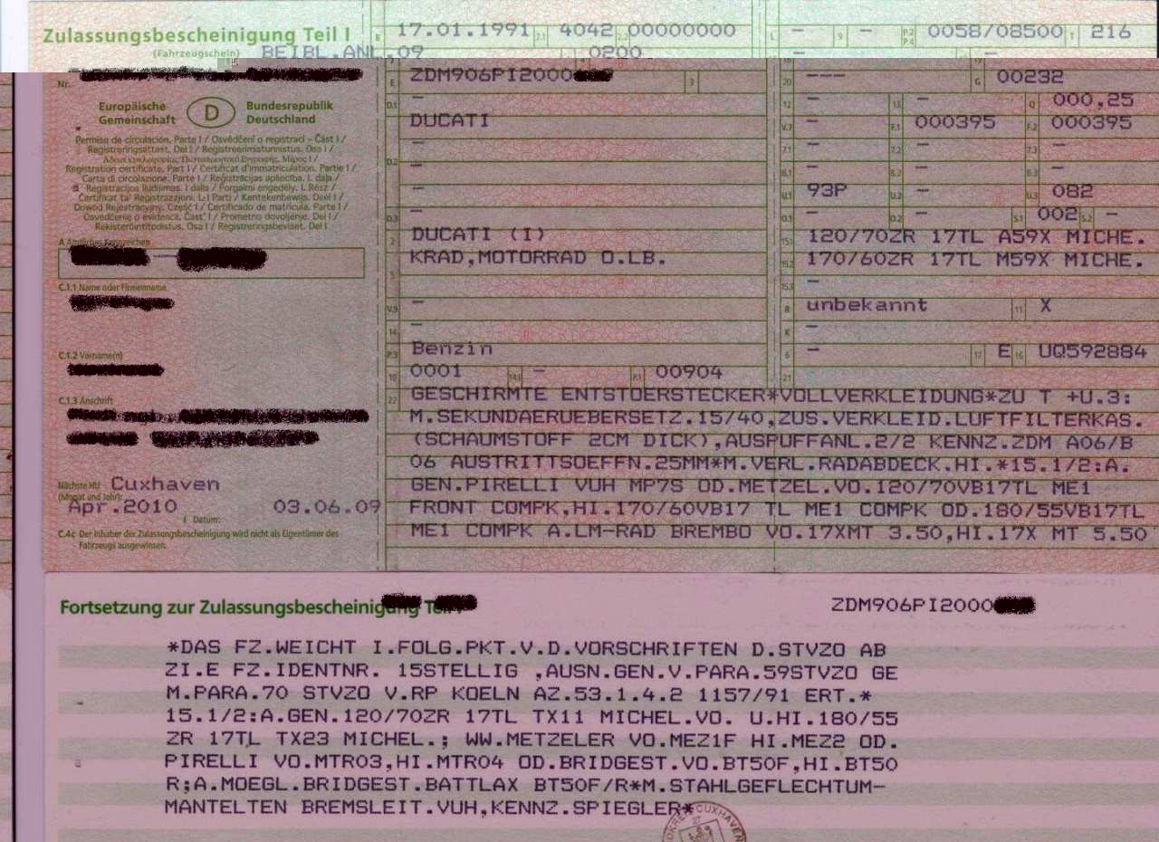

Thank´s for the fast information. Can anybody send me a copy of a German 91 Model Fahrzeugbrief or Zulassungsbescheinigung
Teil 2.
Many Thanks

- Bock900r
- Posts: 153
Re: How many Horsepower
Have a look at my scan
- (152.82 KiB) Downloaded 878 times
Rüdiger

Thank you so much.
The answers are that quick.

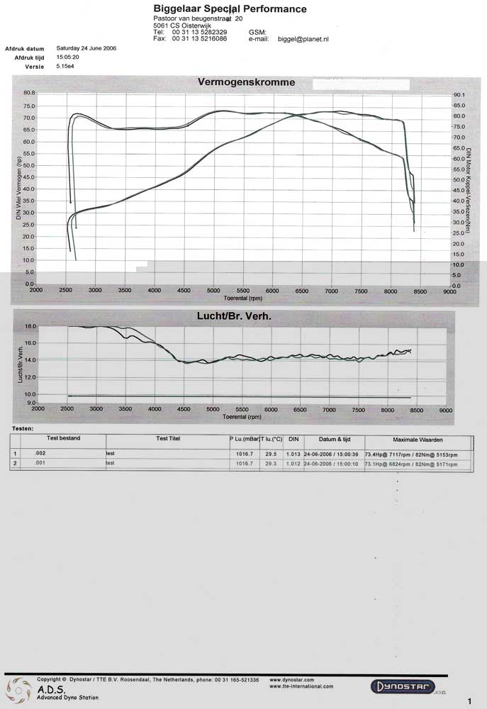

looking at G's secong graph...is that the torque figure, it doesn't look right, max torque @ 2500rpm...
this 907 must of been fitted with a diesel engine
Cheers Claude.
'92 907...numero 2046
'92 851...in progress
- JoKing
- Posts: 362
Its correct.
Mine from before the engine-swaps looks the same. Not that much HP, but it looks equal.
most diesel engines won't do 2500 and max out on torque at much less than half of thatmax torque @ 2500rpm...
- 907pasonut
- Posts: 604
I'm not talking about large trucks or diesel locomotives...many passenger diesels red line at 4500-5000rpm with max torque at 2000rpmhiggy wrote:most diesel engines won't do 2500 and max out on torque at much less than half of thatmax torque @ 2500rpm...
back to the 907 if you look at the first graph, that looks right, good torque from 4000rpm and max between 5k and 8k rpm, without much mechanical knowledge I would say the first graph resembles my bike, ie: not much grunt down low
actually I just realised that first graph is mph not rpm...

- JoKing
- Posts: 362
Here you can see some 907s curves.
The green curves show my 907 before the conversion, with 130tkm on the odo.
The red one is the much "younger" 907 with lower mileage.
The Blue one is the same one with slightly optimized engine.
(This bike is for sale, it is the frame # 2000)
/Edit: You see KW. To get HP, you have to multiply the values by 1.36
On this picture you can see my 907 engine, compared to the first run after the conversion. This was with a Multistrada 1000DS-2-Valve-mapping.
Its sad i have no torque-curve and the later, optimized curves saved.
But when i have finished my reassembly, there will be a new run, i think...

- 907pasonut
- Posts: 604
Interesting graphs, thanks for sharing...that green line shows a fairly tired motor, not much happening untill 3300rpm.
