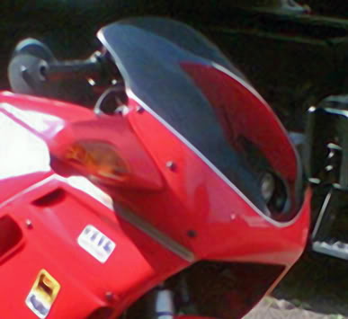

+1, I don`t even see it.how have you modded the headlamp?

timmetje wrote:thanx! i used an old headlight from a ford scorpio, i put some pictures in the greetings from a 906 owner post

If you look closer at the picture he posted earlier you can just make it out in the lower part of the painted"windscreen"

ok, here it goes
filling with foam
then i put polyester on the foam
polyester primer
more primer and a lot of sanding (dont do it in the living room lads, your wife will kill you!
the headlight unit from the scorpio, slightly modified
sanding painting sanding painting, etc, etc
keeps you of the street
filling with foam
polyester primer
