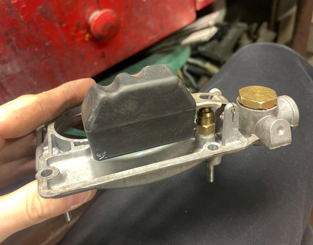

Is this correct float for paso carburator? In manuals i only find round float.
Posts: 2013
Re: Ducati Paso 750 complete restoration
Mmmm I could only find round ones too . That float looks a bit special with the dimples .... possibly to clear jets in the bowl.

Yup, float looks the same from one of the two webers I have.

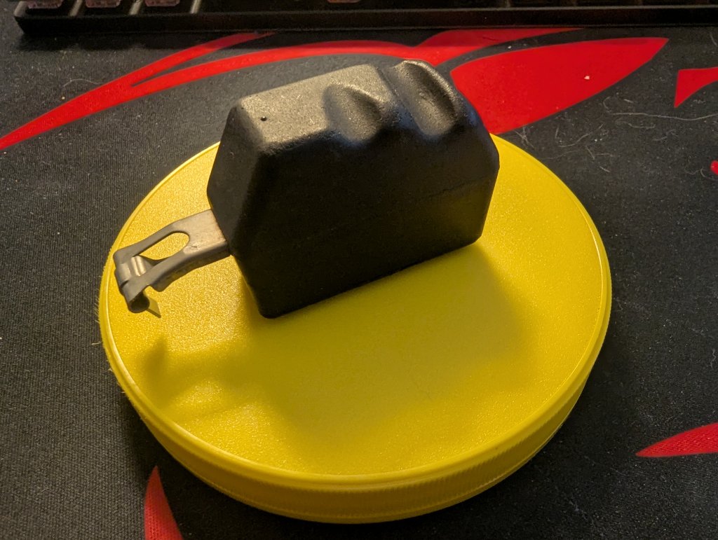

So I left Paso sitting for few day and here we go again. Carburetor float didn't closed the fuel and i have engine full of fuel.
I drained the oil. And maybe it's not electric. What is correct float height because I'm finding two different values on the internet. Also interesting thing is that float was closing fuel correctly before for at least a month.
Posts: 3381
level with the top of the card as you hold it upside down. It is possible for these floats to get saturated with fuel as they get older keeping them from closing.
